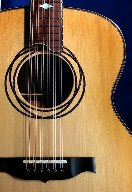

Dave, you wouldn't happen to have a pic of a bridge with the two strings per hole idea would you? I am pretty sure I've seen it somewhere before but I can't remember wher it was I saw it.
PostPosted: Thu Jul 20, 2006 1:45 am
[QUOTE=Dave Rector] Dave, you wouldn't happen to have a pic of a bridge with the two strings per hole idea would you? I am pretty sure I've seen it somewhere before but I can't remember wher it was I saw it.[/QUOTE]
Dave,
Howard Klepper very kindly sent me a photo of one of his wonderful guitars so I hope he doesn't mind me posting it here:
PostPosted: Thu Jul 20, 2006 2:32 am
Thanks again Dave! Man, does Howard do great work, or what?
